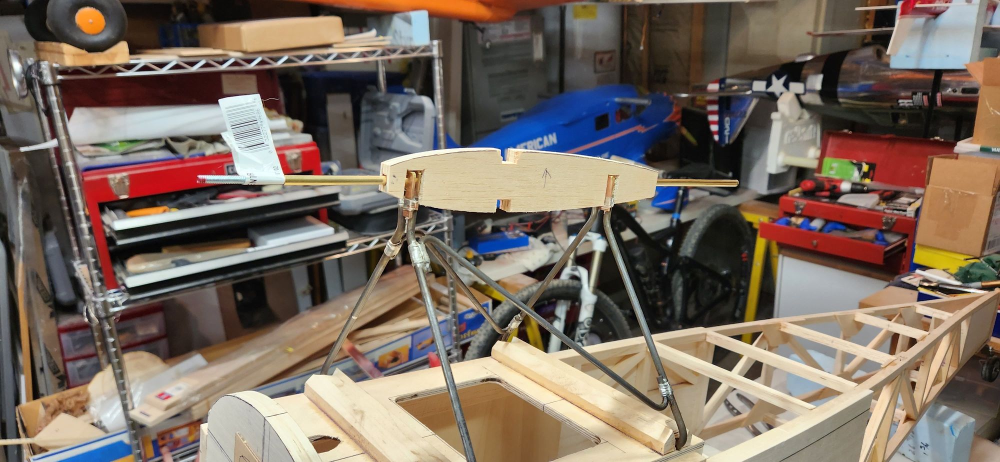

bryanmiick October 4, 2023
This center rib is a sandwich of ply and balsa with a brass tube thru the center that aligns and attaches the top wing. The inner tube gets a threaded rod glued into it with a nut to hold the top wing on. incidence and front to back alignment are double checked and cabanes are epoxied in their hardwood mounting blocks. the whole box will be epoxied when the wings are on just to double check alignment.
