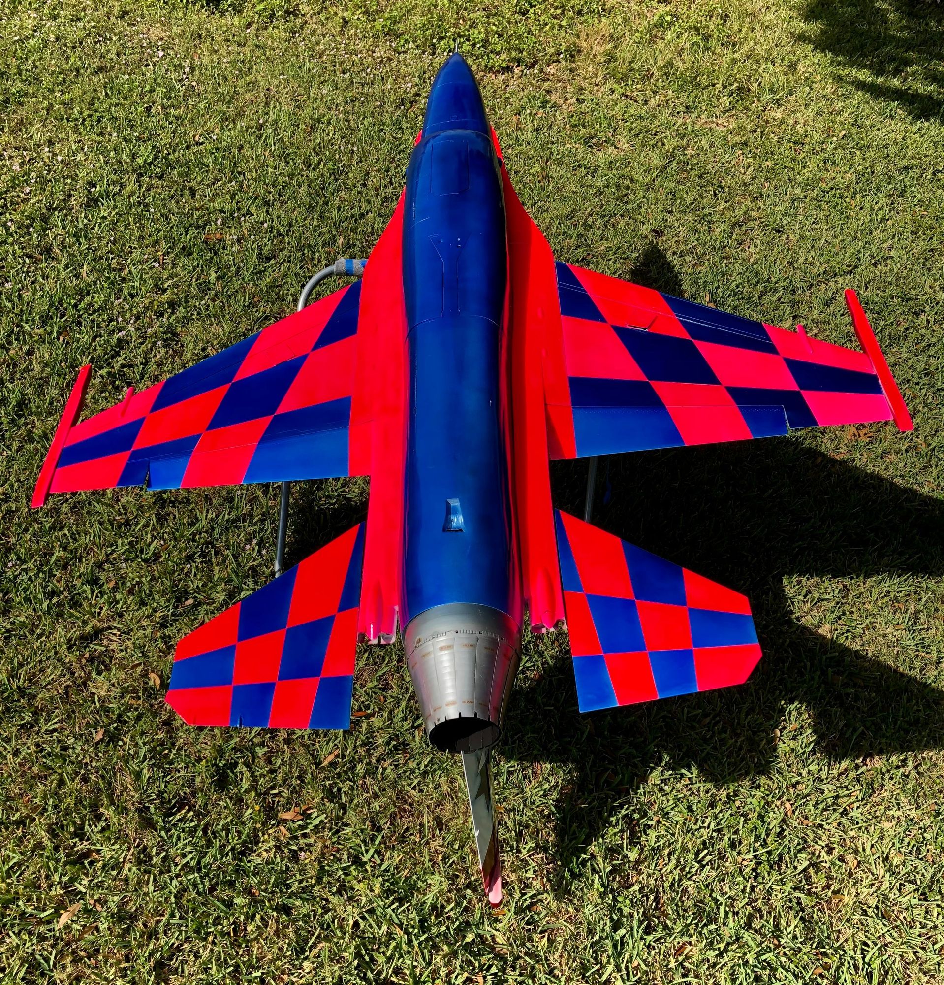

Here the bottom is finished. So gaps and joints can be filled. Consider installing fiberglass sheeting or plywood to help fill the gap and then use the epoxy and Microballoon to fill the gap. Microballoons will create a strong, but lightweight filler surface. And can be sanded to meet the contours. Microballoons also creates more surface area for the epoxy to adhere.
